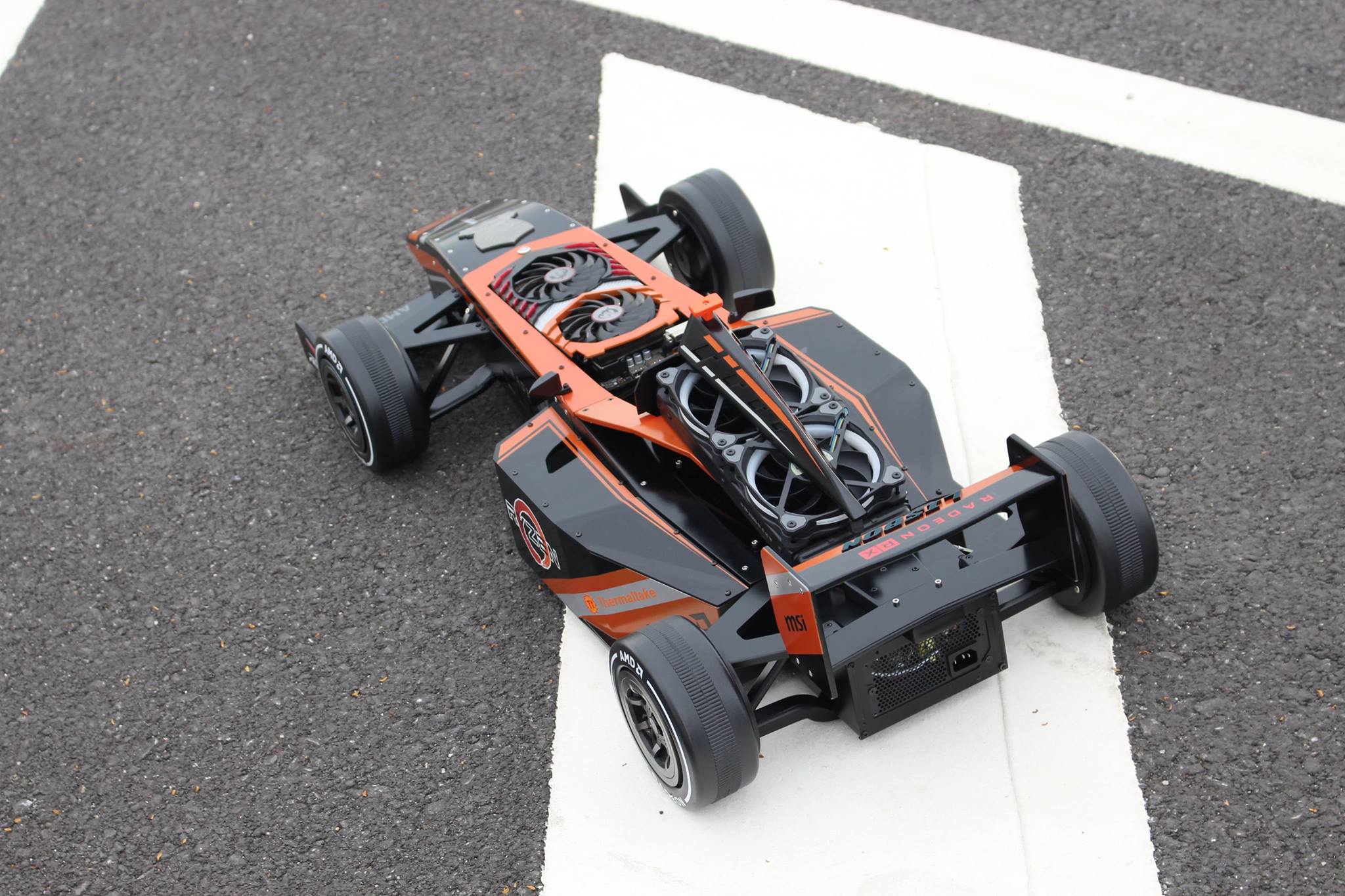

Spoiler Spoiler Spoiler
http://imgur.com/a/Q7NHJ
EDIT: rohkem pildimaterjali https://www.facebook.com/pg/Suchao-moddingdesign-1127784403922074/photos/?tab=album&album_id=1475963532437491
