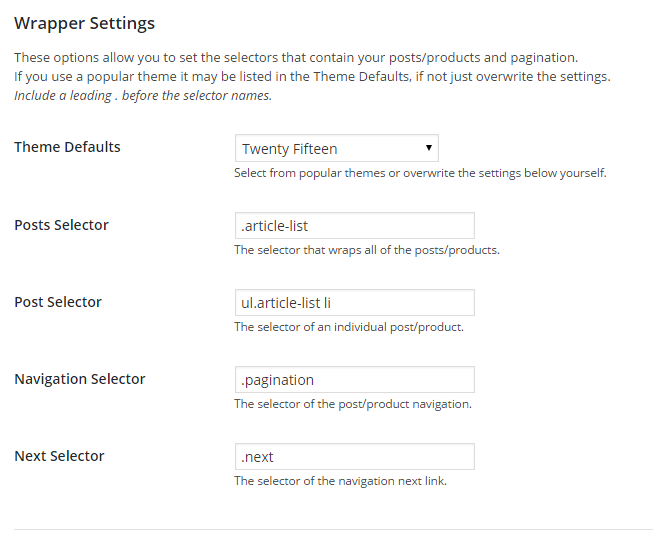

Olen viimased tund aega mässanud ja ei saa kuidagi tööle infinite scrolli. Kui plugin on välja lülitatud, siis töötab teema enda pagination väga hästi. Kui plugin sisse lülitada, siis ilmub vanade pagination nuppude asemele AJAX Loader ikoon nagu peab, aga ühtegi uut postitust ei ilmu. On keegi sarnase probleemi ees olnud ja oskaks nõu anda?
Ajax Pagination Settings:

Pagination.php
Spoiler
<?php
if (!is_singular() && current_theme_supports('loop-pagination')) {
global $wp_query, $wp_rewrite;
$total = $wp_query->max_num_pages;
if ($total > 1) {
$current = (intval(get_query_var('paged'))) ? intval(get_query_var('paged')) : 1;
$pagination_args = array(
'base' => @add_query_arg('paged', '%#%'),
'format' => '',
'current' => $current,
'total' => $total,
'end_size' => 2,
'mid_size' => 1,
'type' => 'list',
'prev_next' => TRUE,
'prev_text' => __('Tagasi', kopa_get_domain()),
'next_text' => __('Edasi', kopa_get_domain())
if ($wp_rewrite->using_permalinks())
$pagination_args['base'] = user_trailingslashit(trailingslashit(remove_query_arg('s', get_pagenum_link(1))) . 'page/%#%/', 'paged');
if (!empty($wp_query->query_vars['s']))
$pagination_args['add_args'] = array('s' => urlencode(get_query_var('s')));
echo '<div class="pagination clearfix">';
echo paginate_links($pagination_args);
echo '</div>';
loop-blog.php
Spoiler
<?php if ( have_posts() ) : while( have_posts() ) : the_post(); ?>
<li id="li-post-<?php the_ID(); ?>">
<article id="post-<?php the_ID(); ?>" <?php post_class('entry-item clearfix'); ?>>
<div class="entry-thumb">
<?php if ( has_post_thumbnail() ) : ?>
<a href="<?php the_permalink(); ?>">
<img src="<?php echo wp_get_attachment_url( get_post_thumbnail_id($post->ID) ); // 53x53 ?>" alt="<?php echo get_the_title(); ?>">
</a>
<a class="meta-box" style="" href="<?php the_permalink(); ?>">
</a>
<div class="meta-box-entry-categories"><span class="entry-categories"><?php the_category(', '); ?></span></div>
<?php endif; ?>
</div>
</article>
<div class="uudise-autor"><?php the_author_posts_link(); ?></div>
<div class="entry-new-heading"><span><a href="<?php the_permalink(); ?>"><?php echo get_the_title(); ?></a></span></div>
</li>
<?php endwhile; else : ?>
<?php get_search_form(); ?>
<?php endif; ?>

Inspector tool'i ei ilmu mõni JS viga mis vihjeid annaks?
