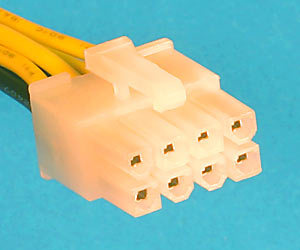

tonu89 kirjutas: |
Ei mis sellest ma sain vähemalt informatsiooni siin ilma, et uue teema tegema pidanud oleks.  |
Ära ütle, et sa oleks tõesti EPS12V surunud PCI-E v2.0 toitepessa
Alustuseks, on pin-out vale...
Rääkimata sellest, et vajalik 12V Amperaaz on liiga vilets...
CPU & GPU ei ole 1:1 samad asjad...
Rääkimata selles, et nagu eelpool öeldud... valesti ühendamine on tehtud võimalikult "raskeks" ... ja seda täiesti meelega
Etz kirjutas: |
AJ kirjutas: |
Parem oleks jah kui saaks standard kaabli aga sellest saaks suht lihtsalt aretada. |
Ideeliselt võiks selle sealt ära osta ja 6pin-to-8pin otsas sealt võetud pistikuga 6 pin otsa ära vahetada...
Nope, ei mängi välja, need ei ühildu...
Make sure that you don't try to plug an 8 pin 12 volt cable into the 8 Pin PCI Express power connector on a video card. The two cables look very similar so it's easy to get the two confused. 8 Pin PCI Express power cables are usually labeled to distinguish them from 8 pin 12 volt cables. The PCI Express cable usually has "PCI-E" printed on the connector. If there are no labels then you can usually use wire colors to tell the two kinds of cables apart. An 8 pin 12 volt cable has yellow wires on the same side as the connector clip. An 8 Pin PCI Express cable has black wires on the clip side. The two power cables are also keyed differently so you can't plug one kind of power cable into the other kind of connector. But as with this kind of connector, you can sometimes force the wrong kind of cable into a connector if you push hard enough. Make sure you have the right kind of cable before plugging it in. The two are definitely not compatible with each other. |
