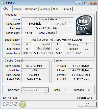

ASUS Rampage II Extreme Sets Core i7 OC Record
Spoiler Spoiler Spoiler
http://www.techpowerup.com/77764/ASUS_Rampage_II_Extreme_Sets_Core_i7_OC_Record.html
Ära siia kliki

R2E tundub jah parim OC plate olevat i7-le(Kui ikka tõsiselt tegeleda OC-ga) thumbs_up.gif

Stock to Clocked - Core i7 920 at 3.8GHz
http://www.tweaktown.com/articles/1672/stock_to_clocked_core_i7_920_at_3_8ghz/index.html
E.
duck hits 5.5GHz with Core i7 on ASUS ROG Rampage II Extreme
http://www.nordichardware.com/news,8442.html
