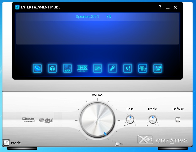

Kui keegi soovib sama protseduuri läbi teha, siis siinkohal lühike (nojah) spikker Titanium HD kaardi lineaarseks seadmise kohta (tavalugeja võib selle spetsiifilise lõigu rahumeeli vahele jätta):
01. Start / ControlPanel / Sound / Playback : Speakers (check)
02. Start / ControlPanel / Sound / Playback : Speakers / Properties / Levels : Mute (check:kõik 4 alumist valikut), jäta ainult ülemine avatuks
03. Start / ControlPanel / Sound / Playback : Speakers / Properties / SoundBlaster : DisableSoundBlasterEnhancements (check)
04. Start / ControlPanel / Sound / Playback : Speakers / Properties / SoundBlaster / Settings (AudioControlPanel) / Mode : AudioCreationMode (check)
05. Start / ControlPanel / Sound / Playback : Speakers / Properties / SoundBlaster / Settings (AudioControlPanel) / EAX Effects : EnableEAXEffects (UN-check)
06. Start / ControlPanel / Sound / Playback : Speakers / Properties / SoundBlaster / Settings (AudioControlPanel) / Encoder : Dolby/DTSencoding: Off (check)
07. Start / ControlPanel / Sound / Playback : Speakers / Properties / SoundBlaster / Settings (AudioControlPanel) / Bit-Matched : EnableBit-MatchedRec (check)
08. Start / ControlPanel / Sound / Playback : Speakers / Properties / SoundBlaster / Settings (AudioControlPanel) / Bit-Matched : EnableBit-MatchedPlay (check)
09. Close
10. Start / ControlPanel / Sound / Playback : Speakers / Properties / Advanced : 24bit/96000Hz (select - vali mingi kindel väärtus mida vaja on)
11. Apply / OK
12. Start / ControlPanel / Sound / Recording : Auxilary (check)
13. Start / ControlPanel / Sound / Recording : Auxilary / Properties / Advanced : 24bit/96000Hz (select - vali sama kindel väärtus mida juba enne valisid)
14. Apply / OK
15. SoundBlasterX-FiModeSwitcher : AudioCreationMode (select)
16. SoundBlasterX-FiModeSwitcher / AudioCreationModeMixer : Snapshot (open) : Default (select - nullib võimalikud eelseaded)
17. SoundBlasterX-FiModeSwitcher / AudioCreationModeMixer : Snapshot (open) : RMAA96kHz (select - vali seesama väärtus mida juba enne valisid)
18. SoundBlasterX-FiModeSwitcher / AudioCreationModeMixer / Settings / Clock : 96kHz (select - vali seesama väärtus mida juba enne valisid)
19. SoundBlasterX-FiModeSwitcher / AudioCreationModeMixer / Settings / Bit-Matched : Enable (check)
20. SoundBlasterX-FiModeSwitcher / AudioCreationModeMixer / Settings / Encoder : Disable (CMSS-3D, EAX, 24-Bit Crystalizer, GraphicEqualizer, THXsetup)
21. Close
22. SoundBlasterX-FiModeSwitcher / AudioCreationModeMixer : 96kHz rate (verify)
23. SoundBlasterX-FiModeSwitcher / AudioCreationModeMixer : 2/2.1 speakers (verify)
24. SoundBlasterX-FiModeSwitcher / AudioCreationModeMixer : 100% wave stereo (verify)
25. SoundBlasterX-FiModeSwitcher / AudioCreationModeMixer : kõik liinisisendid 0%+Muted või-144dB (verify)
26. SoundBlasterX-FiModeSwitcher / AudioCreationModeMixer : rec.source line-in@50%, 0dB gain (verify)
27. SoundBlasterX-FiModeSwitcher / AudioCreationModeMixer : kõik nähtavad EffectsReturns Muted (verify)
28. ...uhh, puhh, ja ongi esialgu TEHTUD!
Tavalugejat-kasutajat huvitab aga kindlasti see, et helikaardi kasutamiseks on ette nähtud 3 peamist tööreziimi, millel igaühel on omamoodi disainitud võimsad kasutajaliidese paneelid, igaüks veel omakorda mitmete alam-tab'idega:
-1) Audio Creation Mode (heli salvestamiseks, sünteesimiseks, testimiseks, lineaarseks muusikakuulamiseks)
-2) Entertainment Mode (filmide vaatamiseks, toonitud muusikakuulamiseks)
-3) Game Mode (arvutimängude mängimise helidele suunitletud)

Siinkohal paar täiendavat screenshot-näidet, kuidas näevad välja selle helikaardi enda "Control Console" helimiksimise-mode efektilisamise alam-aknad. Esimesel screenshot-näitel on juhuslikult avatud kõnemoonutaja paneel ja samas on avatuna rippmenüült näha ka teised võimalikud väljavalitavad erinevate efektide sättimise alampaneelid. Teisel screenshotil on neist siis ühe näitena omakorda avatud "Reverb" paneel kogu oma võimalusteküllusega... NB! Tegemist ei ole mingi eraldi helitöötlustarkvaraga, vaid lihtsalt helikaardi endaga kaasasoleva nn. baasutiliidiga, mis mõeldud eelkõige lihtsalt nagu "volume control" paneeliks
